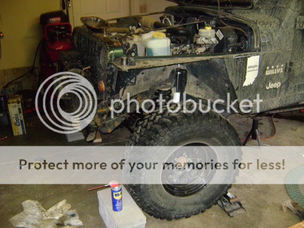

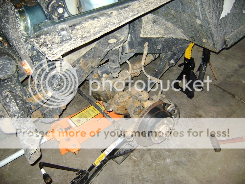

my two inch lift (that is for sale) only have the fronts out right now the rear will be later this week

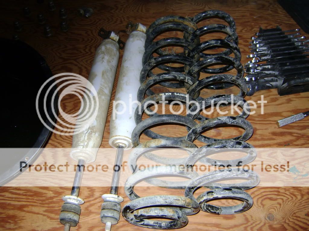

my front coils and shocks removed

today i finally started real work on it. took off the trac bar at the axle housing (just sitting there now more work later) then went to get pitman arm off thats where im stuck. the drag link side is off but i cant get it off at the gear box any suggestions?

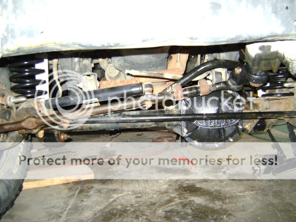

well spent 10 hours on it today and still not finished but i did manage to get the front completly done. as for the rear both coils are in both lower control arms trac bar relocation bracket are installed but the problems i ran into that made me quit for the night driver side shock thats bolted to the frame i broke one bolt off. passenger side broke one bolt other one is rounded i dont know what to do its beyond my knowledge brandon told me to heat it but that is right by the gas tank i dont have any experience heating something like that and dont feel comfortable doing it. if it wasnt for those three bolts i'd be done with my lift but they had to go and break! as for tomorrow ill be putting in the transfer case drop kit and hopefully figure something out

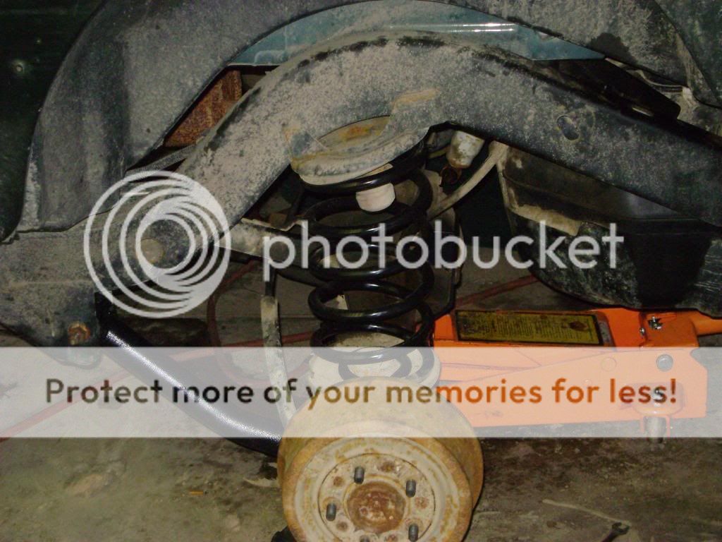

 Post Posted: Mon Feb 23, 2009 12:08 pm
some pictures of my progress so far
front stance
side view
drop pitman
rear coils installed
