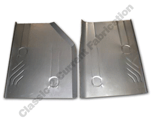

 Post Posted: Wed Apr 22, 2009 4:22 am
bought front and rear floor pans all four...should be here next week.
hope this pic works
front
rear
got all four pans including shipping for 184 bucks. they are 18 gauge, they appear to not be factory perfect, but neither is this xj...will let everyone know how these work out since floor boards seem to rot away in this forum.

no...got the floor pans out of the box and set in the jeep, but no fabbin or welding done yet...been trying to get my yard cleaned up and trailers moved out of the driveway...

got the floor pans, nice start without fabbing a bunch of just plain sheet metal...i know it saved me time
cleaned and prepped and cleaned and cut somemore
then...there was a break where it was busy...finally put the time in to get them done
progress at last...
after welding them in, i used a body filler that is water tight
