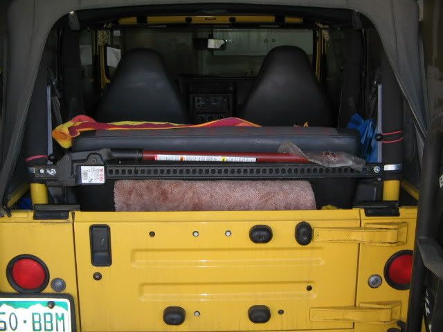

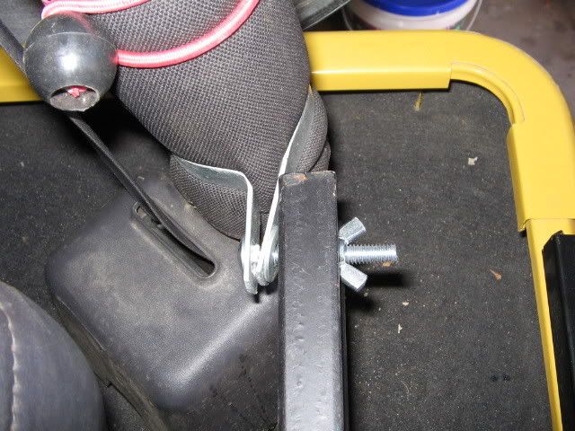

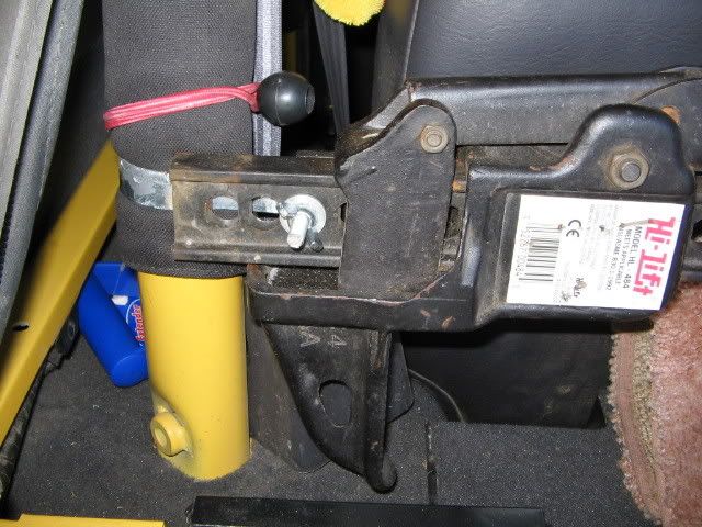

If it were me, I'd mount the lights on top of the winch/fairlead.
As far as the jack mount, I posted a link to the orginal "Yzer-mount", I'm sure if you google it, something will come up.
Anyhow, all it is, is a couple of chainlink fence hooks around the rear-roll bar, with some carriage bolts through them.
Here are a couple of pics, hopefully you can get the idea:

PC wrote:
By the way, what happened to the base on that jack? Looks like it was removed.
just know the roll pun thats in there from the factory out, and replace it with a 1/4" removable pin.
The whole set up can be made for about $10.
