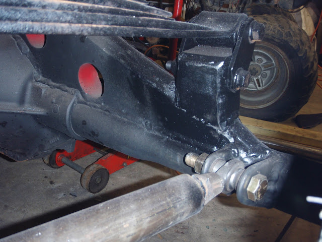

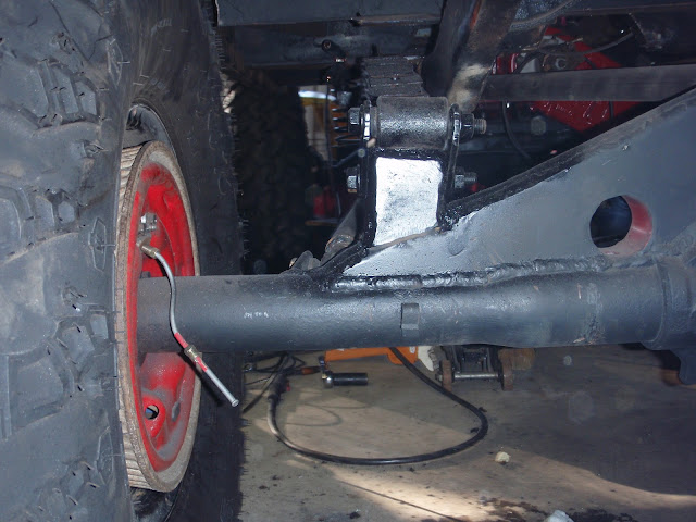

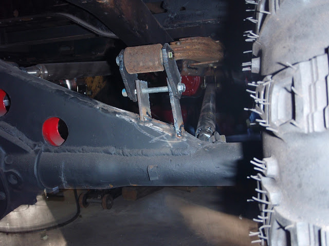

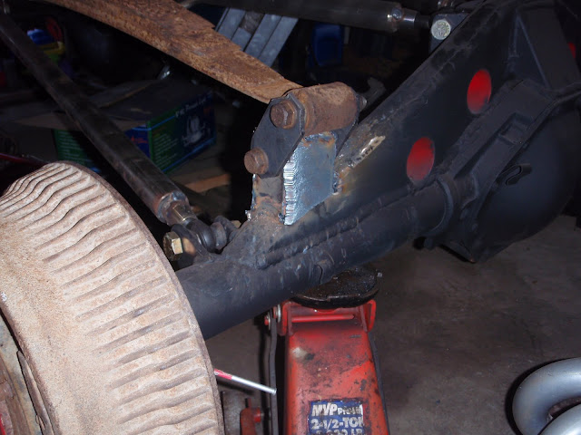

I got a LITTLE free time Saturday afternoon to at least ROUGH out the quarter elliptical setup. I'm going to box in the spring mount on the frame rail, and ad triangular gussets on the bottom, and an additional top plate to go over the top of the frame rail and onto the top spring plate.
I'm going to box in the rear axle shackle mount, and round the shackles out for a cleaner look. I was really running low on time. The springs will all get painted too. Remember, this is rough assembly, not finished product.
What do you think? I thought the shackles were bent back pretty far, but in reality, a quarter elliptical system gives you more drop than rise in your flex, so when they drop down 30" it's going to be straight or forward an inch. I think i'll run it this way for and see if they need moved.
I'm a little hesitant to show these pictures only because it looks like a total hack job and i'm not proud of it....YET. It'll clean up nicely with a few more hours.
From CJ6
From CJ6
From CJ6

are you going to reinforce the frame area where the springs mount? seems like there will be a lot of "twist" load there. Maybe a crossmember and some bracing?
 Post subject: Re: CJ6 buggy build
 Post Posted: Mon Nov 15, 2010 11:48 pm
Yup, probably a 3" C channel across there. Plenty of room for it, i also need bump stops on the springs.

Why do the rear springs like that? wouldnt doing a coil setup or coilover be easier and better?
 Post Posted: Tue Nov 16, 2010 8:08 pm
cost of quarter elliptical so far - $0
coils would cost - $0 but i never like the stability of my TJ on 4 coils. I like a stiffer rear setup.
cost of 2 coilovers - $1300
you do the math :-)
The quarter elliptical gives the same range of motion as the coilovers. So why not?

OK another " if i dont ask i dont know" question....
"I thought the shackles were bent back pretty far, but in reality, a quarter elliptical system gives you more drop than rise in your flex, so when they drop down 30" it's going to be straight or forward an inch. I think i'll run it this way for and see if they need moved."
so with your shackles set back the 2 -3" they are is that with the axle at full flex/stop UP? or is that at mid range?
edit,, on more thought on this... will the flex UP correct the shackle? just as you think the flex down will?
Um....well if the spring was perfecty flat on level ground (and it's close now), then either up or down motion would correct the shaclke angle. It doesn't matter THAT much, not like it's going to be driven on the road at any sort of speed

i got another few minutes to work on it today, i cut off everything i slopped on and came up with a much cleaner install. Same design, shorter post on the axles, cleaner lines, nice shackle. I'll get pics up tomorrow sometime. All in all, i'm very satisfied...and LOVE my plasma

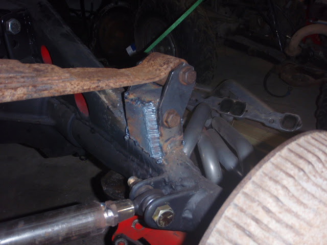

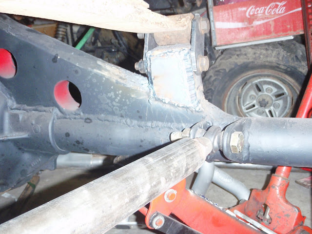

I thought i'd update this build as well. I need to grind the edges smooth, do some finish welding and paint. Looking good though...of course i need to do the other side too.
It appears to be hitting here, but it's not. Optical illusion.

is that a solid piece of steel?
 Post Posted: Fri Dec 03, 2010 3:27 pm
Maybe......
 Post Posted: Fri Dec 03, 2010 3:42 pm
when you weld that, be sure to concentrate your heat on it, so you get proper burn in and penetration!
 Post Posted: Fri Dec 03, 2010 4:38 pm
Boogers and shit!!....you said penetration....
it's 1/4" plate, just made a box out of it.

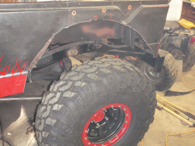

 Post Posted: Mon Dec 06, 2010 3:58 pm
More pics for you pic hounds!
Drivers side finished
Fender well cut out
