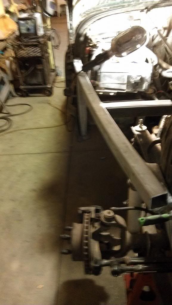

I got a good start on the front bumper. I still need to do some tweaking with the brackets. Get the top plate made and welded on, and get the d ring shackle mounts made and burned on. It's really simple but suit my needs.
I may do a small stinger later after I decide on winch stuff or lights. all of that can be added anytime so...
Just for info. All 1/4 wall steel, bolt holes are sleeved, bolts are grade 8. It should not go anywhere. :)

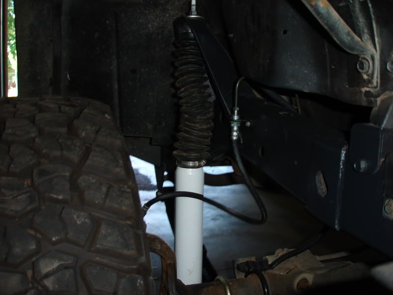

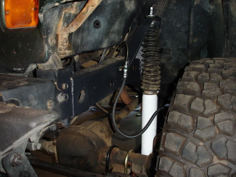

Thanks! I got some new goodies ordered. 1" body lift/new mount kit, rear lift boom shackles, and some new shocks for 0-2" lift.
My shocks are all completely shot. LOL!

Almost done with the front bumper. I got the 3/4 plate d ring mounts made and burned in. I decided to weld them in from the back too. So it took a little longer. I just have a bit more welding and some grinding and i can paint it and be done with it.
I'll get pics ASAP.

Front Bumper done for now. I may add a "stinger" of some sort later IF I get a winch.

Got my goodies today. I installed all 4 new shocks. Damn! Toatally different jeep.

So started working on the jeep again. Working on the rear bumper now. In my tinkering around the rear(lol). I found some frame rust. It was not showing until I started digging at it. I need to do some patch work on both sides underneath. Other than that it's pretty solid. I wil get some pics of the new bumper. The main bumper is pretty much done but now I need to fix the frame rust before I mount it.
Also 2.5" lift springs are here and waiting to go on when the frame gets fixed. I had a longer brake line made when I redid the rear brakes. Gonna take my fronts over to TFE and have my wifey make me some stainless ones that are about 5" longer. Because they are maxed out now. :)
Bumper work. Still need to build all the mounts, also I will eventually build the tire carrier but for now I have enough to deal with.

Pics o my new brake lines.
Yup, it's lifted now.
^plus the cb mount
finished cb wireing. Yes it is fished thru the window frame except for the antenna wire for now.
And for some pieces of flair! LOL!
New, old ass polished sparkley 70's shift knob for the trans, and badass holmes wrecker winch disengagement knob for the 4wd. :)

I have been bad at updating this thread. The 8.8 is ready to go in one i get my motor mount lift and make the new trans mount and flat skid.
I have done some fender work. Slow going due to the holidays and beeing sick a lot.
So far...
I have one almost skinned and need to finish weld it up and claean it up. Other one the main section is started.

Looks awesome! How did you get that square stock to curve with the hood?

For the square tube I used a harbor freight tube roller. It's the A frame one. I made 3 flat rollers for it on the lathe. It comes with only round rollers.
This is what it looks like from harbor freight. Just imagine flat rollers till i find a pic...
I little time and a few passes theu the roller and it did what i wanted it to do. I have pics of the roller i used somewhere... I'll see if i can dig them up.
As far as the 1/4" plate piece that follows the grill down to tie into the frame. A few hours with some chunks of old rail road steel I use as anvils and a 2 lb sledge and you have that.

Not really too much new going on. I snapped my rear driveshaft at the badlands. Rugged ridge replaced it with no issues. It seemed to be a factorydefect. I also got an xj front shaft cut down and rebuilt for a spare cause the busted shaft wrecked my wheeling trip.
Also started noticing axle wrap issues cause of my cheap springs. Lol. I made an anti wrap bar so I don't wreck anything.
Picked up a smitty built xrc8 used for cheap and am making a winch plate for it. Other than that trying to save and find time for my next wheeling trip.
I'll post some pics of the anti wrap bar and winch stuff.when I can .
